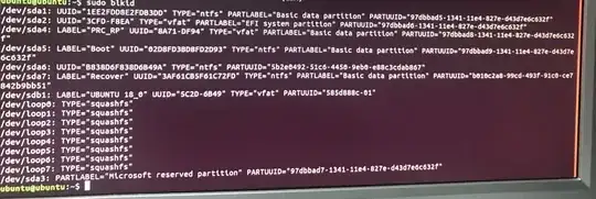

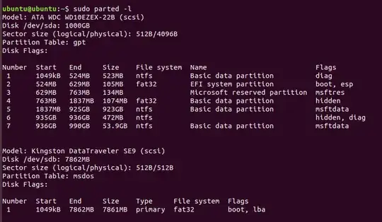

I then checked the disks in the live Ubuntu environment using sudo fdisk -l and sudo blkid. When I did this I saw that none of the partitions matched the properties of Ubuntu that are mentioned in this article under the terminal section.
I will include some information about versions, etc. at the end.
In conclusion I can use the F8 key to get into Windows 10 with no problem, but when I don't press F8 I see a GRUB terminal. Using F8 to get to Ubuntu doesn't work. Boot-Repair doesn't work, and I don't see the partition Ubuntu was on. How do I get Ubuntu back, and if it's gone, how do I make sure that everything works like it used to (the dual boot setup) with or without a fresh Ubuntu install? I don't mind losing the files on the Ubuntu part, but the files on Windows 10 are quite important.

fdisk and blkid results:
fdisk result
blkid result
Note: the sdb1 drive that says Ubuntu is just the Ubuntu live USB.
sudo parted -l result:
sudo parted -l

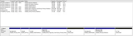

Windows Disk Management:
(Click image to enlarge)

The minimum disk space required to install Ubuntu is 10GB, and the recommended disk space is at least 25GB. If the information in the screenshots is correct, you do not have much of an alternative except to do a fresh installation of Ubuntu. Furthermore all the information in the 4 screenshots can't be correct, because the results of Windows Disk Management and Ubuntu terminal programs are contradictory.
The unallocated disk space in Windows Disk Management is split into two 9.77GB partitions which is not the ideal way of allocating space on the disk from the standpoint of recycling the unallocated disk space to install Ubuntu. Furthermore Windows Disk Management recognizes a different partition layout than sudo fdisk -l and sudo parted -l. This raises the question of whether anything that you do in Windows Disk Management to further change the partition layout of disk /dev/sda will be recognized by the Ubuntu installer or whether it will just add new problems to the problems that you already have. Your C: partition has 859.60GB, 41% of which is free. 60GB (or more depending on how much disk space you need to store files in your home directory) from this partition could be used to install Ubuntu on. sudo parted -l identifies this partition as partition 5 of size 923GB.
Before you make any changes to the partitioning, it would be wise to consider that your first priority should be to ensure the integrity of your files on the Windows partitions. This would be a good time to back up these files, if you have not already done so. You have a 1TB external hard drive that can be used to save backups.
