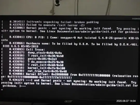

I have installed Ubuntu 20 alongside Windows 10, then removed Ubuntu and grub issues were also solved, now I am unable to install Ubuntu 20 again.
I am installing through USB and a black screen comes with some lines.
error message
It is when I am booting the installer. Ubuntu is not installed on my system.

Looks like your installer is corrupt.
  1. Re-download the installer .iso
  2. Check the hash to verify a good download
  3. Re-make the install USB with the verified .iso.
