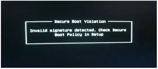

secure-boot-violation-invalid-signature-detected

Choose a Linux Distribution That Supports Secure Boot: Modern versions of Ubuntu — starting with Ubuntu 12.04.2 LTS and 12.10 — will boot and install normally on most PCs with Secure Boot enabled. This is because Ubuntu’s first-stage EFI boot loader is signed by Microsoft. However, a Ubuntu developer notes that Ubuntu’s boot loader isn’t signed with a key that’s required by Microsoft’s certification process, but simply a key Microsoft says is “recommended.” This means that Ubuntu may not boot on all UEFI PCs. Users may have to disable Secure Boot to to use Ubuntu on some PCs.

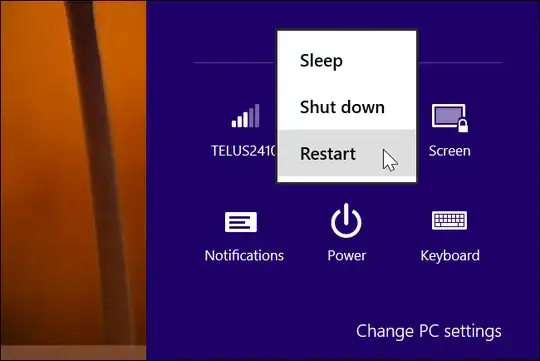

You can control Secure Boot from your UEFI Firmware Settings screen. To access this screen, you’ll need to access the boot options menu in Windows 8. To do this, open the Settings charm — press Windows Key + I to open it — click the Power button, then press and hold the Shift key as you click Restart.
restart-from-settings-charm

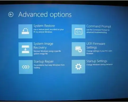

Your computer will restart into the advanced boot options screen. Select the Troubleshoot option, select Advanced options, and then select UEFI Settings. (You may not see the UEFI Settings option on a few Windows 8 PCs, even if they come with UEFI — consult your manufacturer’s documentation for information on getting to its UEFI settings screen in this case.)
access-uefi-firmware-settings

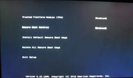

You’ll be taken to the UEFI Settings screen, where you can choose to disable Secure Boot or add your own key.

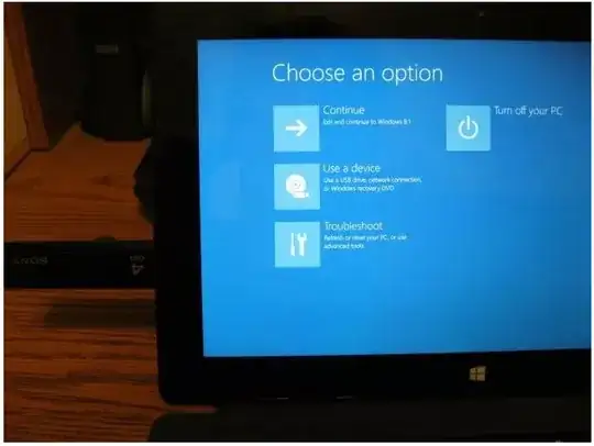

You can boot from removable media by accessing the boot options menu in the same way — hold Shift while you click the Restart option. Insert your boot device of choice, select Use a device, and select the device you want to boot from.
After booting from the removable device, you can install Linux as you normally would or just use the live environment from the removable device without installing it.
windows-8-uefi-choose-boot-device
