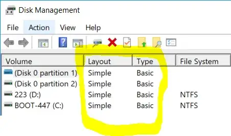

First, while still in Windows, right click on the [START] button of Windows (the Windows icon at far bottom left) and choose Disk Management. Find your H: drive; you will need to know which physical drive it is on and which partition it is.
Also, confirm by looking in the columns Layout and Type that it is a Basic Disk Type with Simple Layout and not a Dynamic Disk, because Linux can't use a Dynamic Disk.
Screenshot from Disk Management
Once you've done that, while you are still in Disk Management, delete the H: drive partition, and make note of the physical drive it was on from the Volume column.
