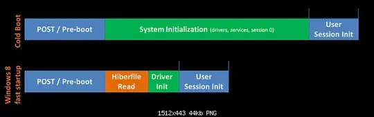

Fast boot explained with an image:
During fast boot the system loads the hiberfile and does not use the files on the filesystem.

Fast boot in Windows 8 is a way to boot the system faster because the needed data to boot (Drivers, User session, etc..) are stored in a hibernation file (hiberfile) and are loaded when the boot process begins, saving the user between 40% and more boot time.
Since Hibernation mode is a way to "freeze" whatever you were doing before shutdown and loading it again when you start the computer (this includes opened apps, sessions, drivers, the last office doc you were editing...) it creates a problem when you want to copy stuff from Ubuntu to Windows after a hibernation, or "fast boot" as it is called on Windows 8 because anything that changes between hibernating and booting again is lost.
