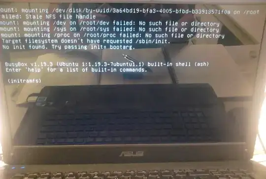

It used to run before I upgraded to Win8.1 but now, whenever I choose Linux in the boot menu it just returns some messages saying that it failed to mount. The errors are the following:
errors (Sorry for the crappy pic)

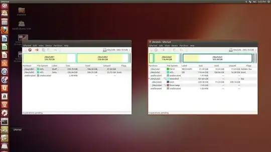

Note that Boot-Repair is selecting /sdb in Restore the MBR of: sdb (generic mbr). I have no other option to choose in here besides others for sdb, although linux is installed in sda3, sda5 and sda6 as you can see from this screen
gparted screenshot

Upgrading Windows 8 to 8.1 will do the following to your boot loader:
  • Depending on what hardware Windows is working on, the boot loader for Linux might work or it might throw that error you are showing. This is because grub is no longer the boot manager but rather the Windows 8 one. I have had laptops boot correctly using the Windows bootloader (Which is blue with several light blue options) and some that have completely failed, forcing me to install the Live USB and recover the boot loader from within the Ubuntu Live System or doing it everything from zero.
  • Again, depending on the hardware and system configuration (Like Fastboot enabled) the boot loader might simply fail forcing you to either recover the boot part from an Ubuntu Live system or install it from scratch.
There are several points you really need to worry when you are at this point:
  1. Do not enable fast boot. Leave it disabled. For more information see Installing Ubuntu Alongside a Pre-Installed Windows with UEFI because this will create some issues when trying to registered the boot changes on the new boot manager (Windows based) and even detecting correctly the boot parameters and partitions with grub-repair or GRUB.
  2. Sometimes boot-repair from the Ubuntu Live system will fail on this cases. This problem put together with the fact that the upgrade to 8.1 creates even more issues to any non-windows system (Go Microsoft you are the best!) GRUB might even suffer from 8.1. Please see this answer for a guide to fix this: Cannot Restore Grub After Windows 8.1 Upgrade It is the only one that has worked so far for me.
  3. To solve many of the issues coming from Windows 8.1 please disable fast boot and follow Grub not showing on startup for Windows 8.1 Ubuntu 13.10 Dual boot which might help.
In the end, to solve boot issues from Ubuntu's side, first disable fast boot (hibernation mode) and then try to boot-repair the system or follow any of the advices here. I can only imagine what Windows 9 or 8.2 will bring to the whole compatibility table. Sorry you had to suffer this.
