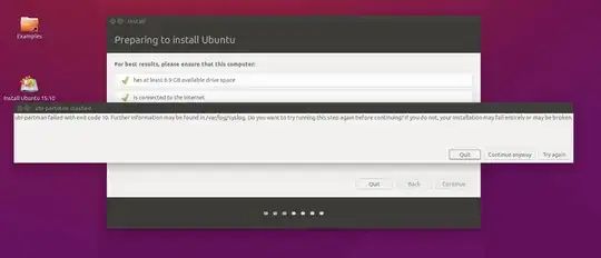

Finally, turning fast boot off made one difference. Now, when tying to install I immediately get this message (before it asks about any partitioning): error message
clicking try again always fails, clicking continue anyway leads me to the screen where I selected where I am located but I am not sure I want to continue with that installation.
