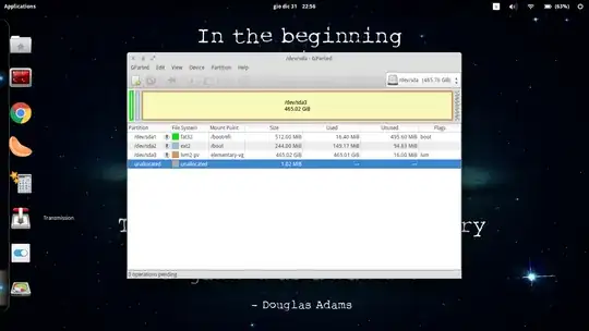

2) Here are my partitions:
Just a screenshot
Should I just increase the size of the unallocated space? Or create a new partition?
EDIT 2 - also, I just noticed that gparted doesn't show any swap partition... is that normal?
Just a screenshot
You're really asking a question about Elementary on a Ubuntu-only site. You're on the wrong site. Please migrate/transfer your question to the correct SE site. Everyone who claims that Ubuntu sites or any other not-directly to the project related site is a proper support channel for Elementary users is deliberately misguiding users or too lazy to properly answer questions. Stop listening to these people.
That being said check the type of your partition table (you probably have a working UEFI setup), be careful and read up how to properly resize LVM.
