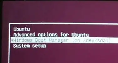

Short Answer: Yes you will get a screen at startup that lets you choose between Windows and Ubuntu. enter image description here
