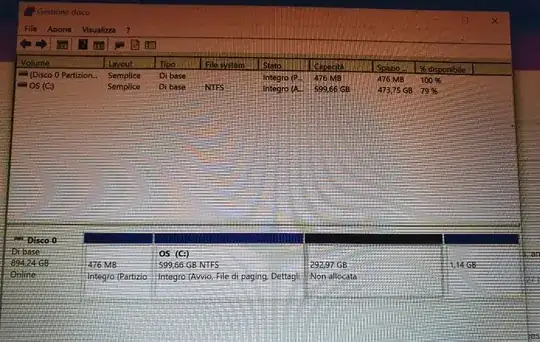

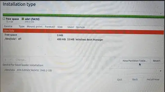

I am trying to install ubuntu alngside windows 10 on an asus laptop. However, when I come to the partition screen the ubuntu installer only detects of the whole 900gb disk only the 400 mb partition on which windows is installed and does not see the 300gb free space I have allocated for the installation.
ubuntu installation screen
partitions in windows
I have a BIOS system and fast boot and secure boot are disabled. I am trying to install ubuntu 20 lts.

Update: After seeing the images (sorry if you linked them in the first place I didn't click on those links) I can tell you why I think this happens. If you look at your windows partition manager screenshot you have the small partition, the windows partition, empty space, and space in use at the end (in blue). I understand that you rearranged partitions, but in this process something didn't like to Ubuntu installer.
I would like to know what is the space at the end. You should be able to see the partition table and if it's healthy to create a partition by booting Ubuntu Live and from a Terminal selecting:
fdisk /dev/sda
You can use h for help p for printing the partitions n for creating a new one. If you create a new one fdisk will offer you only the space that it has available. Resizing and moving partitions and creating new after is dangerous, please do a backup before continuing if you didn't.

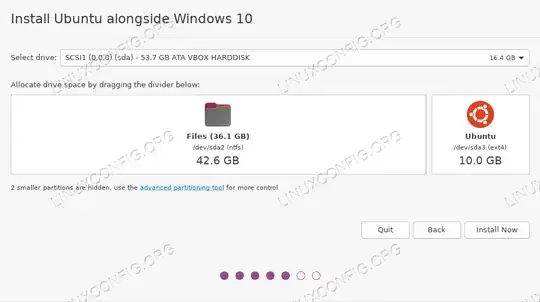

So in your case you can't see the free space so you can try this:- 1st - First allocate the free space by right clicking the free space and then merge it to your main partition where the windows is installed . 2nd - Now select ubuntu along side windows and select the partition where the windows is installed and you will see that you can partition the main drive there as you choice by dragging the line between the screen just like this enter image description here
((Image credit :- Linuxconfig.org)) OR if you care about your data and want to take safer way the make the unallocated space a named drive such as 'D Drive' and then select this drive during the installation of Ubuntu and do the same as shown in the image. 3rd - Now the space you didn't gave to Ubuntu will be left in D Drive or the name you gave. complete the installation. After you come in windows and open disk management you will see that the drive you named will have the space you left and a drive with no name, there the Ubuntu is installed.

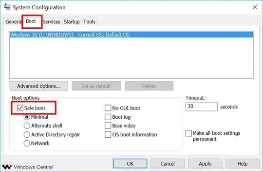

First you will need to enable "Safe Mode".
  1. Press Ctrl+R (It might be ⊞ Windows+R ... I haven't used Windows in years) to bring up the Run dialog
  2. Type: msconfig
  3. Choose the "Boot" tab, then down in "Boot options" select "Safe Mode", ensure "Network" is set, then [Apply] and [OK]
Thanks to Windows Central
Note: Even with "Network" selected, some people do not have a working WiFi connection in Safe Mode. Be sure to have a wired connection ready just in case.
