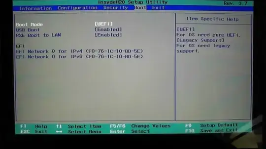

I got a laptop which has pre-installed Windows 8.1 and I am now using Ubuntu 14.04 with Windows 8.1 in dual boot mode.
If you are going to install Ubuntu 14.04 , I will say it is prefereable to install Ubuntu in (U)EFI mode because of problems specified in this thread.
You can find out which Boot mode you are using from these articles.
article1 article2 article3
If you still have doubt and open BIOS and find out which entries are listed in (U)EFI mode and legacy mode. UEFI mode: UEFI boot mode

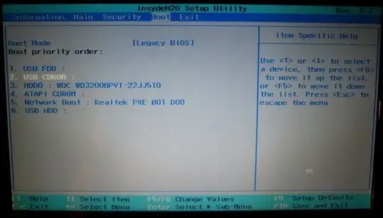

Legacy mode (option 3 is for windows OS): Legacy mode
