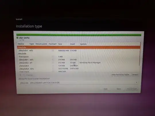

  2. During installing, I choose "Something else" when prompted for where to install. This partition menu makes no sense to me and I don't know if I should, or how to, create a new partition from here for Ubuntu. Here is a screenshot of the partial list (and this is the factory state of the laptop):

Yes it is possible to Boot Ubuntu from another hard drive where GRUB still asks you which OS to run. Create a new partition on your desired drive from New Partition Table, format it to ext4, Mount it to '/' directory. Install Ubuntu then before restart open the terminal and run
sudo update-grub
