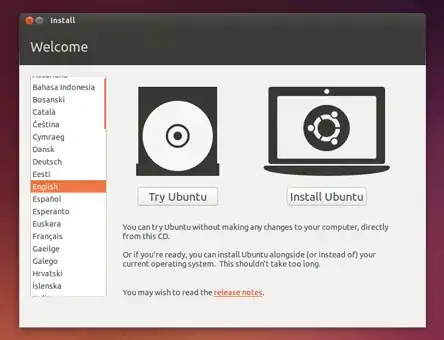

Turns out my computer does something completely different. So I try to find the equivalents and disable the things that look like they should be disabled. I click on the boot override that corresponds to my DVD. It brings to the menu where I can click "test ubuntu" or "install ubuntu".
I click "install ubuntu", follow the steps until the step where I must choose the "installation type".

I see that you have somehow managed to enable "Legacy Boot" in UEFI, since you probably got here: Ubuntu legacy boot
So, what I'd like you to do, is disable it and go back to the previous state. If you UEFI boot with a 64-bit Ubuntu image (DVD), you ought to see a GRUB menu like in this question (the OEM option won't be present, but Try Ubuntu and Install Ubuntu will be.): Ubuntu UEFI boot
To get a 64-bit image, download the AMD64 (or AMD64 + Mac) ISO from http://cdimage.ubuntu.com/releases/trusty/release/. Only the 64-bit version currently supports UEFI, and you are most likely to detect Windows 8 using it, with regular UEFI boot.
