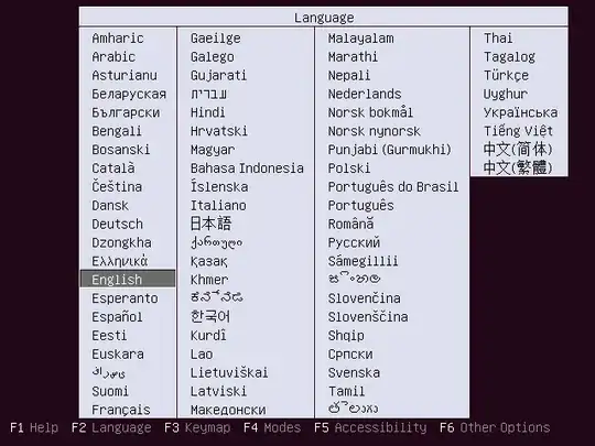

  • Press Enter and select English:
    screen shot 2

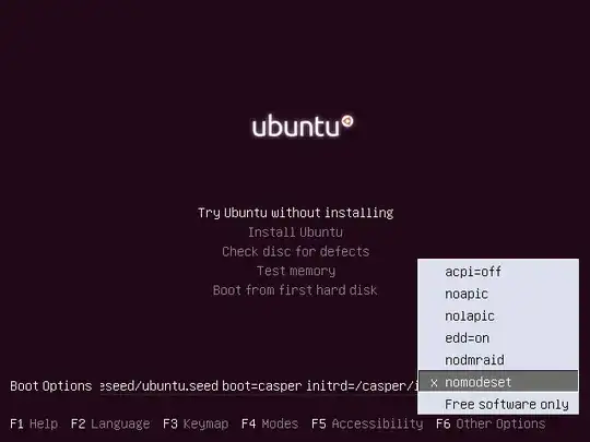

  • Press F6, use the keys to go down to nomodeset, and press Enter. An x will appear to its left. Then press Esc, and press Enter to "Try Ubuntu without installing."
    screen shot 3
You can also try acpi = off and nolapic if nomodset also shows up as a black screen.

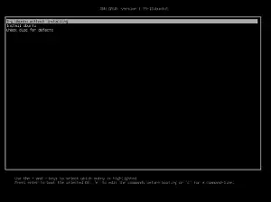

Ubuntu's installer 'when attempting to run in UEFI mode) will hang and stop due to different manufacturer's implementations of the UEFI specification and will hang in different ways. To identify if your machine is booting in installer UEFI mode you will see
screen shot 4
REF: UEFI Community Ubuntu Documentation Section 2.4

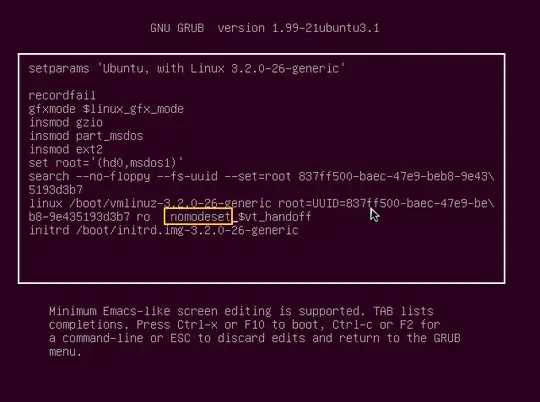

The solution is to boot Ubuntu once in nomodeset mode (your screen may look weird) to bypass the black screen, download and install the drivers, and then reboot to fix it for ever.

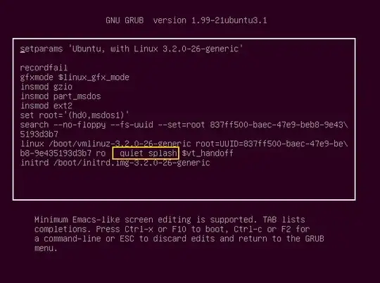

  • Start your computer, and press the Right Shift when booting up, to get the Grub menu. Use the keys to navigate/highlight the entry you want (usually the first one).
    screen shot 5
  • Press e to edit that entry, which will show you the details:
    screen shot 6
  • Find the linux entry as shown above, use the keys to get to it, and then press the End key to get to that line's end (which may be on the next line!).
    screen shot 7
    • Enter nomodeset as shown, and press Ctrl+X to boot to where you can successfully install your graphics drivers.

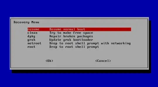

  3. After the recovery mode finishes loading, it should present you with a menu. Select the option about going to the shell with root access (root Option. Last option in the image below)
  4. Now we need to install the Nvidia drivers and update the system. Follow the next lines step by step to do this in the correct order. Also make sure you are connected to the Internet:

Lastly we can execute the grub option in the recovery menu to fix any bootloader issues.

When the grub boot menu comes up, press e to edit the correct boot line. Where it says GRUB_CMDLINE_LINUX_DEFAULT="quiet splash" change this to GRUB_CMDLINE_LINUX_DEFAULT="quiet splash nomodeset".
If this works, then you can install proprietary graphics drivers which should get you going again.
If you have trouble with the above, you can change the above line permanently in the grub configuration file.
Boot into recovery mode (selection from the grub boot loader) and edit the file /etc/default/grub as per the above instructions.
You can edit this file by typing:
nano /etc/default/grub
You'll have to update the grub menu:
update-grub
then reboot by typing
reboot

This is specific to where the install fails and your installation behaves badly.
Requeriments
  • You need access to the Recovery menu, if you don't then look for other options.
  • Internet access with a DHCP-enabled network
  • GUTS! Since this is a delicate process.
Procedure
  1. Once you are in the recovery menu, select Activate Networking.
  2. Now select drop to a root shell.
  3. Run mount -a. (In my case that bad was the installation that I was forced to do this)
  4. Verify that your network is up and running: ping -c 2 4.2.2.2 If this fails run dhclient. ping -c google.com if this fails run dhclient.
  5. Now update your repositories: apt-get update
  6. Install debsums: apt-get install debsums
  7. Run debsums -s. It will give you a list of packages that have problems. Take note of each.
  8. Now reinstall the packages that has problems: apt-get --reinstall install packages.
  9. Update your grub just in case. update-grub.
  10. Reboot and good luck.
