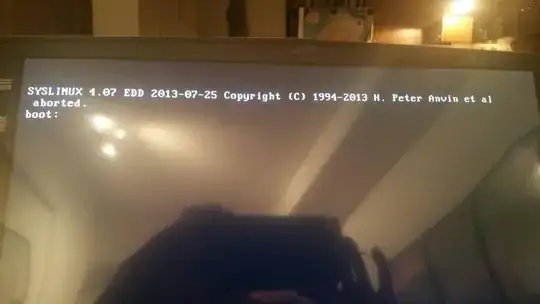

If I press esc I am greeted instead with the following:

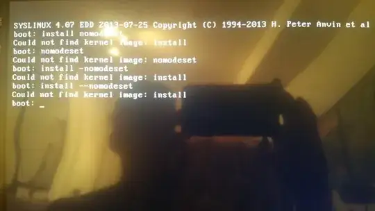

I tried right shift as well:

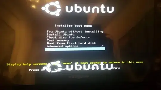

I also thought I could go through suggestion 2 in this answer. Problem here is that I never see the screen where I'm supposed to hit the down key. It just goes straight to the menu (so no selecting a language either). I Get the following menu and I cannot press F6 (or F-anything) to bring up a menu where I can navigate to nomodeset. All options other than "advanced options" or "help" immediately lead to a perpetual black screen. This means that I cannot repair Grub via any solutions offered here
