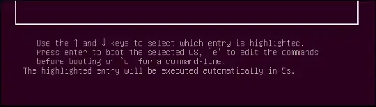

  1. Using this option "nomodeset" by editing the properties of the bootable USB, this can be done by pressing the letter "e" when the advanced menu of the Grub appears:
You can check how this can be done too in this other post.
