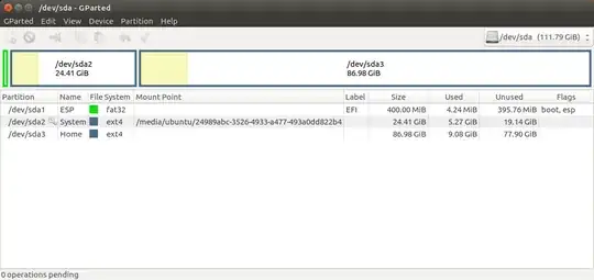

I have a UEFI system drive and a UEFI LiveUsb key and I have installed both 16.04 and 17.04 before using this setup so I don't think that configuration or video drivers is an issue.
I decided that I needed to go down to the metal and create a new UEFI system volume. I created a new GPT partition table, an ESP partition, a root partition and a /home partition but I forgot to set the ESP and Boot flags on the ESP partition. I went ahead and installed 16.04 on this configuration without problems and used it for a few weeks. Today, I decided it was time to upgrade to 17.04 and make sure this was a proper UEFI install so first I set the ESD and boot flags on my ESP partition. I then proceeded to install 17.04 from my UEFI LiveUsb key. The install went OK but when I tried to boot the new system I got a black screen before Grub2 could display the boot screen, even if I held down the right shift key during the boot. Just to be sure that it was not my video card I tried with nomodeset without success.
Gparted view of system drive

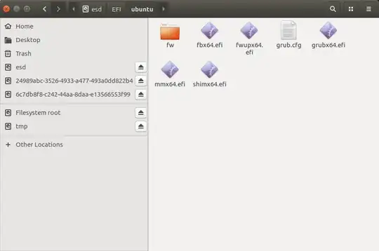

ESD partition contents
