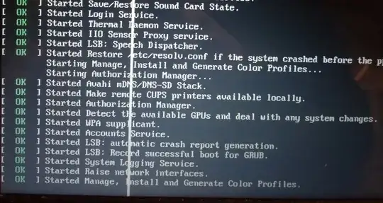

At this point I decided that it would be best to reboot so I pressed the power button and it turned off. When turning the turn my laptop back on, grub opened and I selected to Ubuntu to boot and it leaves me on this screen shown in the below picture. I've rebooted a few times now and it always hangs on this screen.
picture of hang

Your question doesn't give us much data to work on, so lets check the file system first...
Step #1
Lets first check your file system for errors.
To check the file system on your Ubuntu partition...
  • boot to the GRUB menu
  • choose Advanced Options
  • choose Recovery mode
  • choose Root access
  • at the # prompt, type sudo fsck -f /
  • repeat the fsck command if there were errors
  • type reboot
If for some reason you can't do the above...
  • boot to a Ubuntu Live DVD/USB
  • start gparted and determine which /dev/sdaX is your Ubuntu EXT4 partition
  • quit gparted
  • open a terminal window
  • type sudo fsck -f /dev/sdaX # replacing X with the number you found earlier
  • type reboot
