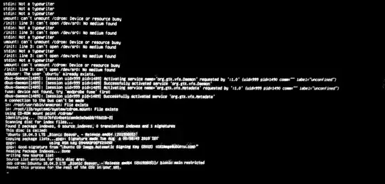

The boot works fine until the pink Ubuntu screen appears for a minute or so and then black screen shows up with some text.
My problem is that the GUI display isn't opening, but the original TTY CLI is working fine. When I run xhost command on it, it says xhost : unable to display ''''
I am using Ubuntu 18.04 on a 16GB Sandisk pendrive as bootable stick on a Windows 7 Lenovo IdeaPad Z560 PC.

it doesn't seem xhost(GUI) thing, but seems more like there is bad sector in boot-sector. this did magic. just, make new bootable-usb of the same ubuntu version.Then, boot up the pc with both the bad pendrive and newly made bootable-usb plugged in.This(bootable-usb) guides you to Install or Savemode.and choose Savemode.Now you see the friendly used-to normal screen of ubuntu.Then use aplication called
BOOTREPAIR
just double click and run it.This repairs your bad sector of boot-sector in the pendrive.Then shutdown PC.Making sure to plug out newly made bootable-usb and Finaly, plugin the pendrive and boot. that's it!!!
