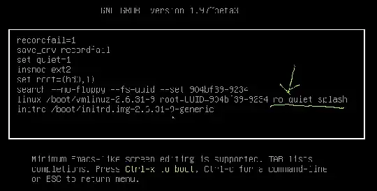

  1. When the USB/CD boots press E on grub menu it will lead to edit the grub.
  2. Find the line which ends with quiet splash and add nomodeset in front of it. So it becomes nomodeset quiet splash. Whatever is there in front of it leave it as it is just add nomodeset in front of quiet splash.
    Grub edit menu
  3. Now press Ctrl+X to boot it normally. It will lead you to Try Ubuntu Without installing option. Now from here too you can install Ubuntu. As install Ubuntu option is always there in the live session. Now after installing Ubuntu we need to change nomodeset thing permanently so that we don't have to do it again.
