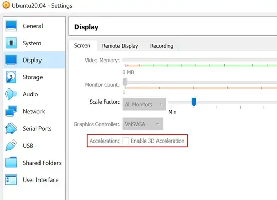

in my case disabling 3d acceleration in VirtualBox settings helped enter image description here
