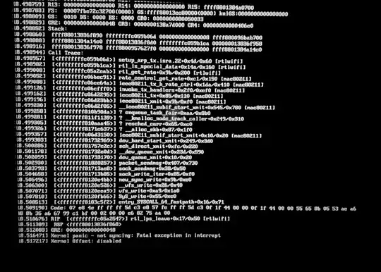

I tried to upgrade from 16.04LTS to 17.10 and got this.
What have I done wrong?

Definitely a kernel problem, the text you're seeing is a logged stacktrace after a kernel panic. Specifically, the kernel panic appears to be caused by something wrong with the rtlwifi (Realtek Wifi) module. Blacklist that module through the GRUB command line to successfully boot into your Ubuntu installation, then try your luck installing newer or older kernels. Here's how:
When the GRUB loader appears, select Advanced Options for Ubuntu and press e to edit the boot line. On the kernel command/boot line that says something like linux /boot/vmlinuz-linux root=UUID=978e3e81-8048-4ae1-8a06-aa727458e8ff quiet splash, append the following text exactly: modprobe.blacklist=rtlwifi then press Ctrl+x to boot with the module blacklisted. If you end up with the same kernel panic, then also try blacklisting the mac80211 module with the modprobe.blacklist=rtlwifi,mac80211.
That should at the very least enable you to actually boot into Ubuntu 17.10. Now you need manually install an older or newer kernel. First, try the newest kernel v4.14.2 http://kernel.ubuntu.com/~kernel-ppa/mainline/v4.14.2/, where perhaps that bug has been fixed. If you get the same kernel panic on bootup using the newer kernel, try the latest version of the lts stable kernel: http://kernel.ubuntu.com/~kernel-ppa/mainline/v4.9.65/
Considering it's the module your Realtek wifi card probably uses, you will be unable to access the internet and must load the debian packages from the mainline kernel repository onto a USB key. Manually install the kernel using dpkg with the precompiled debian packages (you most likely need the headers all, headers generic amd64 and image generic amd64 .debs) at the Ubuntu mainline kernel repository: http://kernel.ubuntu.com/~kernel-ppa/mainline/?C=N;O=D
Inside your installation of Ubuntu, navigate to the downloads folder and manually install the .deb packages using sudo dpkg -i *.deb. Fiddle around and try to find the latest version of the kernel you can run until you receive a kernel panic. Then file a bug on launchpad for the Ubuntu kernel maintainers or directly with the kernel bug tracker at https://bugzilla.kernel.org/.
Booted up with a fresh LiveCD. Overwrote the old system. All fixed.
