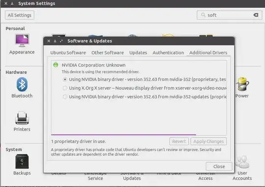

This is a first step for beginners to check extra drivers.
I hope this answer helps anyone who stops by here: Just go to System Settings -> Software and Updates -> Additional Drivers and install the latest NVIDIA driver. Restart your machine afterwards
If after these steps you still do not see your NVIDIA driver you may want to try one of the terminal answers above.
