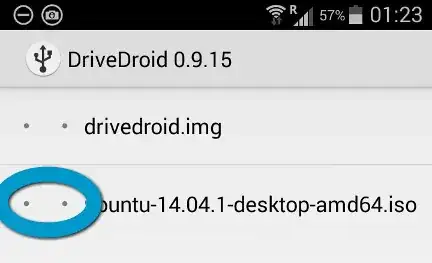

  5. Try reading the answers to My computer boots to a black screen, what options do I have to fix it?.
  6. If you can't follow the answers to My computer boots to a black screen, what options do I have to fix it? you can reinstall Ubuntu from a DVD or USB flash drive by following the instructions in Reinstalling Ubuntu 13.10.
  7. If you don't have an Ubuntu 14.04 live DVD or USB flash drive, there is an Android app called DriveDroid. DriveDroid allows you to boot your PC from ISO/IMG files stored on your phone. This is ideal for trying Linux distributions without the need to burn different CDs or USB pendrives. The DriveDroid application requires root.
    DriveDroid also includes a convenient download menu where you can download USB images of a number of operating systems, including Ubuntu, Kubuntu, Xubuntu and Lubuntu, from your phone.
