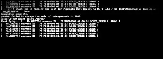

After restarting with my bootable USB, the computer freezes. This is the last screen photo I took.
Do you have any ideas on what I need to do to install Ubuntu alongside Windows 10?

hmm according to the screenshot it seems to be a nouveau error.
nouveau is the open-source nvidia driver and may not support your card. if it's 900M-series.
Can you access the GRUB menu?, if so then try putting
nomodeset
as kernel parameter in place of quiet splash, it should boot you into desktop, but you will always have to put it on boot, unless you install the proper drivers.
Also, do you have by any chance a Skylake processor?, then you at least 15.10 is recommended.
