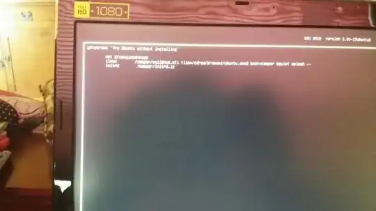

When I hit e this is what I see grub img where do I place nomodeset

You put nomodeset between the quiet and splash part.

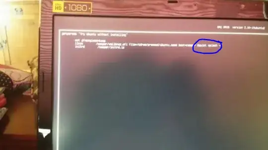

You need to enter the quiet splash text using the arrow keys, as i circled in this picture: &quiet splash
And you have to type in between quiet and splash (or you may say, splash and quiet.) the text nomodeset, so now it looks like this:
getparams 'Try Ubuntu without installing'
       set gfxpoyload=keep
       linux /casper/vmlinux.efi file=/cdrom/preseed/ubuntu.seed boot=casper $ quiet nomodeset splash -
       initrd /casper/initrd.lz
(I'm not sure if the picture says "set gfxpoyload=keep" beacuse it's confusing to see the text.)

Put your cursor 1 spacebar back behind "quiet splash" and type noapic. So it will look like this "xxxxxxxxxxx noapic quiet splash" don't use quotes though and the x's are just whatever it says before where I want you to place noapic and I believe it's f10 to save and boot. Please post if it helped you as that's what I've had to do on my Asus laptop for a couple years and has always worked and I just started using bbqlinux and I had to do the same thing as well to get it to boot but it works with bbqlinux as well. Good luck... ~skulldreamz
