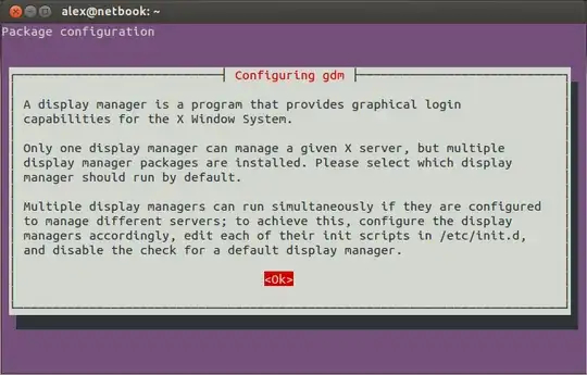

This is a known bug. If you have a Launchpad account, mark it as affecting you to increase its heat, and thereby its likelihood of attracting developer interest.
In the meantime, a possible workaround might be to use a display manager other than LightDM, since the bug appears to have appeared at the same time as LightDM became the default.

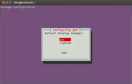

To instead use GNOME Display Manager (which used to be the default), run sudo apt-get install gdm. After the installation completes, a warning about having multiple display managers installed will appear, followed by a dialog asking which you want to use: Display manager warning Display manager chooser Obviously, you should choose gdm.
To restore LightDM, run sudo dpkg-reconfigure gdm to trigger the above dialog to reappear. This time, choose lightdm instead.
