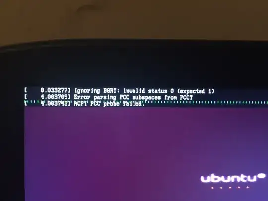

Just got a new ASUS laptop and every things good with it for the most part.
But when I booted from a Ubuntu USB, I believe it was 14.04.3 or later, before the logo even loaded I was left with two side by side screens. Logo appears (loading ubuntu logo), I hit esc read the commands, I have two screens of commands. Ubuntu loads, I have to ubuntus, this is all on my 17" ASUS laptop screen.
This is such an odd thing, I didn't even try to go any further with installation. And I totally dismissed the idea of even putting it on the computer til I realized I have this account… anyway ideas, suggestions, comments, please.
I'm pretty sure this isn't going to have any resolve at least with this version of ubuntu, here are the photos of what I'm referring to.

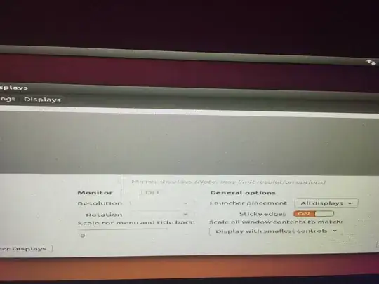

There's really a total of four screens I end up with after it loads.
two screens then they multiply to four just the lines prior to everything breaking in two managed to get settings pulled up-no monitor listed

This most likely seems to be a graphics drivers related compatibility issue.
You say that you have a new ASUS laptop ... ASUS ships with NVIDIA cards.
As you didn't provide further details, I assume it came with GTX 900 series.
For these new adapters it is recommended to use the latest official drivers.
Boot from Ubuntu USB installation media you have created.
Highlight Try Ubuntu without installing - press the E key.
Now add nouveau.modeset=0 to the end of the linux line.
Press the F10 key to boot into the Ubuntu Live desktop.
Install Ubuntu - when finished - install the NVIDIA drivers.
Boot the computer and when the GRUB menu appears ...
Highlight the Ubuntu menu entry and press the E key.
Add nouveau.modeset=0 to the end of the linux line.
Press the F10 key to boot into the Ubuntu system.
When the login screen appears press Ctrl+Alt+F1.
Enter your user name and the password and execute :
sudo add-apt-repository ppa:graphics-drivers/ppa
sudo apt-get update
sudo apt-get install nvidia-358 nvidia-prime
sudo reboot
Notes :
After the drivers are installed adding a boot parameter isn't necessary anymore.
Check whether you have to enable NVIDIA graphics or switchable mode in BIOS.
Install Ubuntu in the same mode as Windows, so select the USB entry with UEFI.
Should there occur problems with nouveau.modeset=0, use nomodeset instead.
Use NVIDIA X Server Settings to switch between intel and NVIDIA graphics card.
