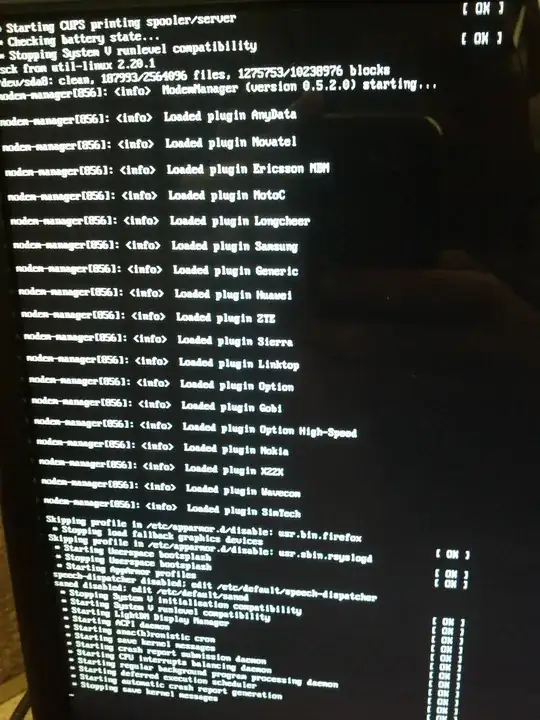

When I boot into Ubuntu, I don't see the Unity interface. Instead it boots into some sort of command line interface (pic attached) What the screen shows

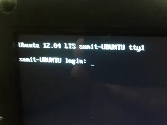

I tried pressing atl + F7, in that case i get a screen showing this: On pressing Atl + F7
Ubuntu was working properly before. I am using propriety graphics drivers from ATI. link to graphics driver. The problem surfaced after I ran software update yesterday.
I'm sorry for the bad quality screenshots. I am not sure how to take screen grabs in this situation.
"If" this is caused because of me using the propriety graphics drivers, how do I solve it? or else, What else can possibly be the issue?

The gui is not able to run because of some problem with the driver you installed. The lightdm is unable to load. To correct the situation:
  • Press ctrl+Alt+f1 to switch to the tty and login
  • sudo apt-get remove --purge [the driver you installed]
    The name would probably be fglrx and some similar name starting with fglrx. Do a web search. The instructions on the amd website should be helpful too on how to uninstall the drivers.
  • Assuming you are able to connect to Internet, you should install the drivers available in the repository. Even After installing these drivers, if things don't work you should search for how to reinstall lightdm.
Sorry for vague instructions. I hope it helps
