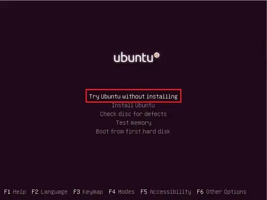

The problem might be with your GPU. By default, Nouveau drivers are installed for Nvidia GPUs and they might cause problems completing boot even during installation.
  1. Switch on and enter GRUB (the bootloader). enter image description here
  2. select the option "try Ubuntu" but do not click or press enter.
  3. Press e to edit the entry.
  4. Come to the line that includes quiet splash, delete it and write nomodeset enter image description here
  5. Then press Ctrl+x to boot.
If it works you need to do it once again after you install Ubuntu. (After doing that you can choose proprietary Nvidia driver and get rid of this problem.)
