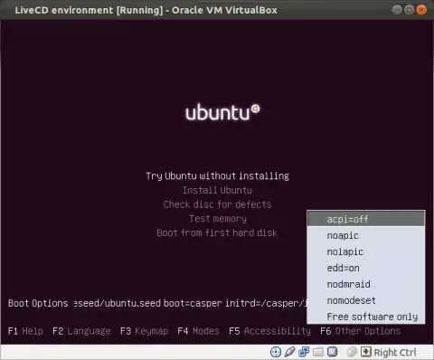

When having this type of problem booting a CD my advice is to check the integrity.
As you boot, select the "Check disk for defects"
The boos screen looks something like this
boot splash
You may also want to check the iso you downloaded. See Ubuntu Wiki MD5SUM for details.
