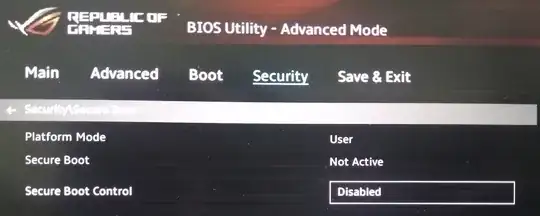

  1. Disabled secure boot in BIOS

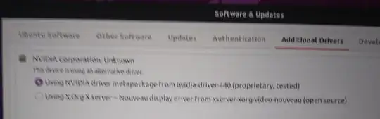

  5. After the installation is complete, Ubuntu asks for restart. But instead of restarting, I closed the dialog, opened the "Update Manager" (as described here: https://www.cyberciti.biz/faq/ubuntu-linux-install-nvidia-driver-latest-proprietary-driver/#verification), I saw nvidia-driver-440 (proprietary, tested). Installed and then shut down the computer.

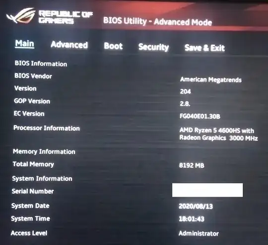

I feel I must be missing something basic. I have added few screenshots for reference.

Update 2 I followed the answer under section "Black/purple screen after you boot Ubuntu for the first time" in askubuntu https://askubuntu.com/a/162076/67529 , going the nomodeset route helped me resolve the problem. Here are the steps I followed.
Following this answer My computer boots to a black screen, what options do I have to fix it? I was able to boot the Ubuntu atleast once in i.e. used nomodeset option from boot screen I removed the "quite splash" and added "nomodeset" Press F10 and went to software updater to install "Using NVIDIA driver metapackage from nvidia-driver-440 (proprietary, tested)". Restarted the laptop and it worked fine after that.
