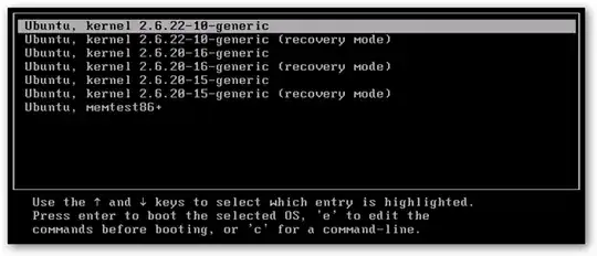

Boot up the machine, and after the BIOS screen, hold down the left Shift key. You will then be prompted by a menu that looks something like this: enter image description here
I've noticed on some systems that timing when to hit the left Shift key can be tricky, sometimes I miss it and need to try it again.
Hit the down arrow until you select the 2nd entry from the top (the one with the recovery mode in the description) and then hit Enter.

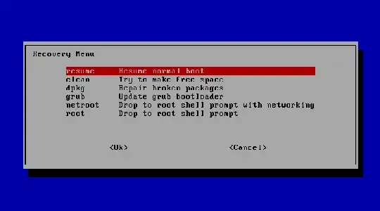

Now you should see this menu:enter image description here
Use the arrow keys to scroll down to netroot, the root shell with networking. This will take a little time to open, but will get there.
Then a series of 4 commands should be run. The first removes the nvidia packages, the second re-installs the Ubuntu desktop (there is a package nvidia-common which is needed but removed in the first step), the third removes the Xwindows configuration files that were modified by the nvidia installation, and the last ensures that the stock video driver in not blacklisted.
sudo apt-get remove --purge ^nvidia
sudo apt-get install ubuntu-desktop
sudo rm /etc/X11/xorg.conf
echo 'nouveau' | sudo tee -a /etc/modules
Following this, reboot your computer with sudo reboot
