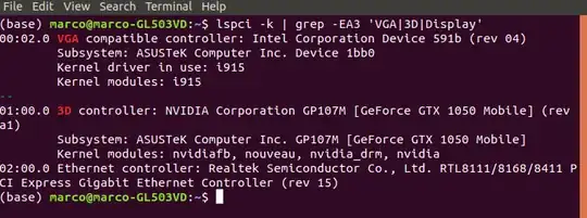

I ran lspci -k in the terminal of a prior version (-72):
https://i.sstatic.net/DIBIW.png
Edit 02: After disabling Secure Boot, lspci -k | grep -EA2 'VGA|3D' returns:
(base) marco@marco-GL503VD:~$ lspci -k | grep -EA2 'VGA|3D'
00:02.0 VGA compatible controller: Intel Corporation Device 591b (rev 04) Subsystem: ASUSTeK Computer Inc. Device 1bb0 Kernel driver in use: i915
01:00.0 3D controller: NVIDIA Corporation GP107M [GeForce GTX 1050 Mobile] (rev a1) Subsystem: ASUSTeK Computer Inc. GP107M [GeForce GTX 1050 Mobile] Kernel driver in use: nvidia
and sudo modprobe nvidia now returns nothing (it just repeats marco@...)?!
When I look under Software and Updates under Additional Drivers, NVIDIA Corportation: GP107M[...] is selected, and under that metapackage nvidia-driver-435.
