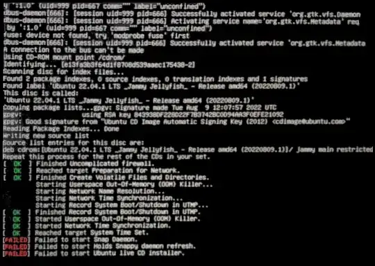

I have been trying to install Ubuntu on Oracle VM VirtualBox configuration:
Base memory 2048MB
video memory 128
graphics controller: VMSVGA
but I keep getting this error:
Failed to start  Snap Daemon.mer
Failed to start holds snappy daemon refresh
Failed  to start Ubuntu live CD installer
I downloaded the Ubuntu 22.04.1 iso
I`m sorry if I'm still not providing enough information. I'm new to this about the image the app says i can only upload a file less than 2MB

1 - Check that virtualization (hardware) is enabled in the BIOS. Otherwise only software virtualization and 32-bit systems can run.
2 - Reduce the amount of video memory to 16mb, it's enough to use Ubuntu and if necessary, after installing it, you can increase it.
3 - Check if the amount of physical memory installed on your computer is enough to create a VM with 2048 MB of RAM. Try reducing it to 1024MB just for testing purposes.
4 - As a last resort, download the ISO again to make sure it hasn't been corrupted. If the problem persists, please download a previous version to test.
5 - Try the Xubuntu distro. It's the same base as Ubuntu, but with an XFCE graphical interface, lighter in terms of RAM consumption and suitable for machines with fewer resources.
