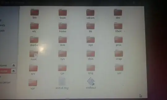

E²: Tried disconnecting and reconnecting the HDD, it didn't work. I used the boot drive to "Try Ubuntu" and tried accessing my HD from there, it seems fine. Idk what it should look like, but the HD is working at least.
Image of what's in the HD:
