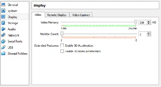

My laptop has an 8th Generation Intel Core i5 8250U processor, with an Nvidia GeForce MX150 GPU, 8GB RAM and a 1TB hard drive. I have installed Ubuntu 16.04 64-bit as a guest OS on Windows 10 64-bit using VirtualBox. Ubuntu was not running smoothly, as there was a lot of lagging.
I searched online for information about the problem and many sources recommended to enable 3D acceleration in the VirtualBox guest OS settings so I did, but after a few loading screens Ubuntu 16.04 doesn't respond and gets stuck on a particular black screen with faint white text of some sort.
Checking Enable 3D Acceleration in the VirtualBox guest OS settings causes a black screen and checking on Enable 2D Video Acceleration results in a message that says: Invalid Settings have been selected.
2D & 3D Acceleration and Video Memory settings in VirtualBox on Windows 10

You are doing exactly the opposite of what you should be doing when your guest OS has limited virtual hardware resources. Enabling 3D acceleration will give the guest OS better performance only if both the host OS and the guest OS have the hardware resources to support it.
Instead of enabling 3D acceleration you should allocate additional virtual hardware resources to the Ubuntu guest OS if it is possible to do so without depriving the Windows 10 host OS of the physical hardware resources that it needs to run properly.
  1. Uncheck Enable 3D Acceleration.
  • In the left pane of VirtualBox click the Ubuntu 16.04 guest OS.
  • Click the gear-shaped Settings icon ⚙️.
  • In the Ubuntu 16.04 - Settings window select Display -> Video tab.
  • Uncheck Enable 3D Acceleration (see below screenshot).

  1. Increase VirtualBox video RAM to the maximum amount of 256MB. From the Windows command line run:
     cd "C:\Program Files\Oracle\Virtualbox"
     vboxmanage modifyvm "Name of virtual machine" --vram 256
    If you run VirtualBox and go to Display in the Settings window, you would see:
