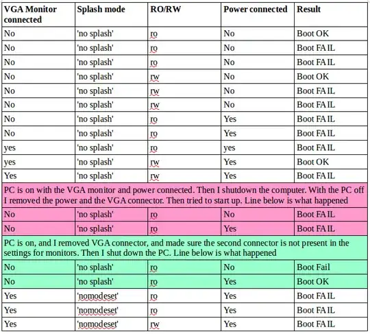

1) I followed the wiki mentioned above and tried 'no splash' and 'nomodeset' in the grub menu. I also played around by making the 'ro' in that same line 'rw' - hoping that additional permissions will help. As well, I plugged and unplugged my second monitor, the power supply and USB devices to see if any one item has a repeatable effect on my problem. It did not. I was hoping to find the culprit causing the problem, but all I found is that everything I tried had no direct impact on the problem. I kept a chart: track of various attempts

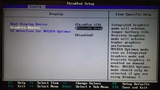

3) I made sure that in BIOS my 'Optimus' is disabled. As well I am using the open source driver, so I hope this is not an 'NVIDIA' problem, but a grub problem. BIOS Settings

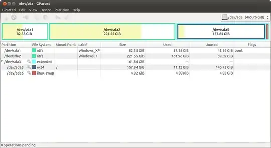

Here is my setup in GParted: enter image description here

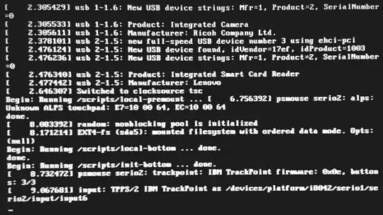

Edit #2************ Several people suggested that I remove my swap partition. I did. However that only changed the problem; the booting got stuck on a different line. Basically instead of hanging up on the swap partition mounting, the boot hung up on my touch pad. When that happened the HDD LED turned off and the PC just sat there for several minutes before I had to restart it. After 3 back to back getting stuck in the same place I put the swap partition back. I took a picture of where it was getting stuck when the swap was gone:

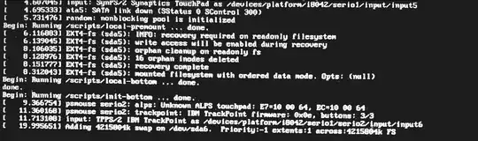

  3. sudo shutdown now //this made my computer act really funny. It didn't quite shutdown correctly and I was looking at a screen with some 'Nouveau' message. I pressed the power button for 4 seconds and the computer shutdown. Here is what I saw:

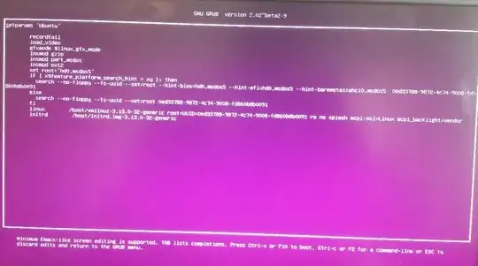

  2. To test if this solution works for you, when the purple grub screen appears press e to edit the entry. then add the following to the end of the line starting with Linux:
acpi_osi=Linux acpi_backlight=vendor final grub entery

I believe it still is a video issue.
And boot parameter for grub is nomodeset with nVidia, but different parameters if booting with Intel. Can you set which video chip you boot with?
See this
After using Boot-Repair I cannot change screen resolution
You test alternative boot parameters at grub menu using e and scroll to linux line. Replace quiet splash or add after those boot parmeter those settings you want to test. Once you get a combination that works edit /etc/default/grub
But you may also need acpi_osi=Linux and/or acpi_osi=Linux acpi_backlight=vendor
gksudo gedit /etc/default/grub
sudo update-grub
So on this line add boot parameters that work.
GRUB_CMD_LINUX_DEFAULT="no splash acpi_osi=Linux acpi_backlight=vendor"
