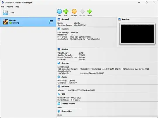

I would like to install the new Ubuntu 24.04 on a VM with VirtualBox. I have setup the new VM by following the Ubuntu website like this:
VM setup
The problem is that when I start this VM and the boot menu appears, I click on Try or Install Ubuntu and then a black screen with only a blinking white underscore character appears.
Here is the zip file with the log. I can't understand what is wrong with this machine.

You may improve your host environment for Ubuntu 24.04 by these steps:
  1. Get and install the latest VirtualBox
  2. Restart your computer and check the CPU settings in BIOS: Intel VT-x or AMD-V should be enabled
  3. Last but the most important: disable Hyper-V with the following command in an elevated PowerShell prompt:
  Disable-WindowsOptionalFeature -Online -FeatureName Microsoft-Hyper-V-Hypervisor

I had the same issue. You see in Storage where the secondary controller says Unattended? I think this means you need to add your ISO file for Ubuntu-24.04 again.
This YT video explains how to do it: https://youtu.be/DhVjgI57Ino?si=fKUo-CNEqB-q2aSd&t=502
The only difference is that instead of seeing "Empty" in the controller ide, you'll see a long path for the "unattended" ISO. After making that change, it should hopefully fix the issue—I know that was the solution that worked for me.
