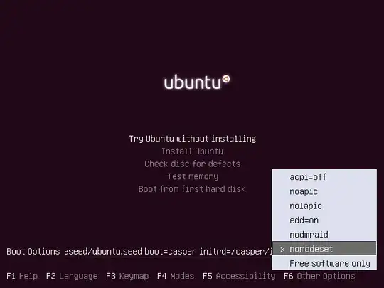

If it doesn't boot, and it shows the purple screen before the computer blacks out, try changing the boot options.
Tap F6 when you reach the purple screen.
Try nolapic and nomodset first. Try all other options of the options mentioned didn't work. Use and to switch options and press Enter to choose the option.
If the computer boots, you are done, not really. After you installed ubuntu, read this thread on the Ubuntu Forums and jump to the "How to permanently set kernel boot options on an installed OS (not wubi)" part to apply the boot option permanently.
