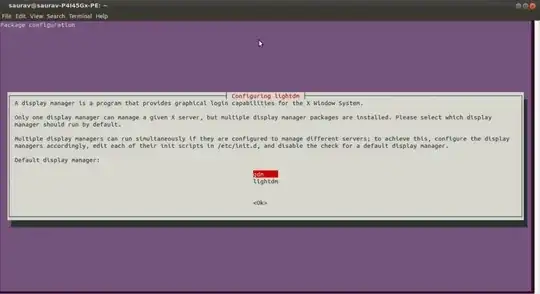

1st Method
Try to reconfigure lightdm (if it doesn't solve your issue then go for 2nd Method)
  • Open terminal(CTRL+ALT+T) and execute following command:
    sudo dpkg-reconfigure lightdm
  • Then chose lightdm from the list.
lighdm
(source: akamaihd.net)
  • Restart your system:
    sudo reboot now
It may fix your issue. If doesn't fix then follow 2nd Method.
2nd Method
Installing a new display manager can fix your problem. Steps to install GDM(a display manager much like lightdm):
  • Open terminal(CTRL+ALT+T) and execute following commands:
    sudo apt-get install gdm
    then chose gdm from the list:
gdm
    sudo reboot now
  • If it's still not fixed, try removing lightdm after installing gdm:
    sudo apt-get remove --purge lightdm
    sudo reboot
Hope these methods solve your issue. Reply for further assistance.
