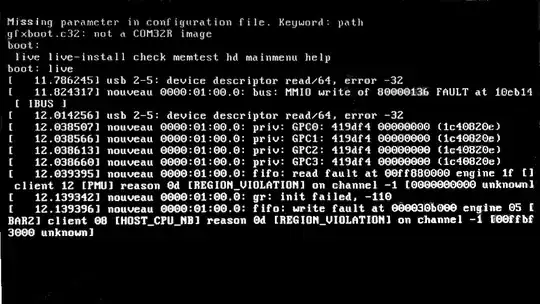

Legacy boot results
I get the gfxboot.c32 error. I hit [Tab], then I tried live and live-install. Both result in this error
