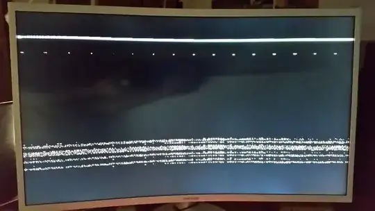

I am trying to dual-boot install Ubuntu 18.04. Upon booting from a USB stick and choosing either 'Try Ubuntu without installing' or 'Install Ubuntu' in the GRUB menu the screen glitches and stays that way,
see pic

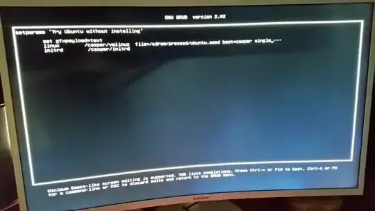

I thought its a problem between the GUI and the hardware so I set the parameters 'gfxpayload' to 'text' and 'boot' to 'single' to boot it with the command-line (the idea being to install graphics drivers)
see pic

When you get to the grub menu you can add the nomodeset boot option. nomodeset tells the kernal to not load the video drivers until the X window server is started. To add this option do the following:
  1. Get to the GRUB boot menu
  2. Highlight the the option that you want to boot to
  3. Press e
  4. Find the line that has linux at the start
  5. Add nomodeset to the end of that line
  6. Press Ctrl-x or F10 to boot.
