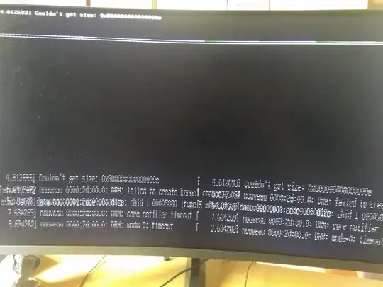

Edit: After an hour in that i am trying to find a solution from the boot settings, i reched that: enter image description here
I think i got some kind of unsupported GPU.
I am using Palit RTX 2070 Super atm.
You have a new and I think very powerful nvidia graphics card. Ubuntu understands, that it is nvidia, because it is trying with the graphics driver nouveau, but it cannot run it in graphics mode.
