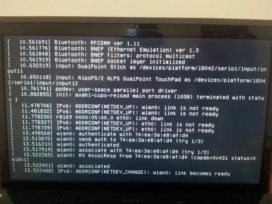

After I installed nVidia driver whenever I start up Ubuntu 13.04 it stays approximately 1 minutes as image shown in link below.
Then it shows me a black screen,
When I press power button, closing screen is coming up and stays "Will now halt". What is the problem with it?

First, at boot select a recovery mode and then the root option (I don't have it in front of me to give you the exact wording).
Try uninstalling and reinstalling Nvidia driver: sudo apt-get purge nvidia then try reinstalling by sudo apt-get install nvidia-current-updates-dev and then reboot.
