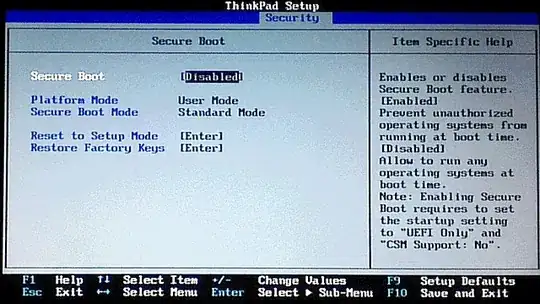

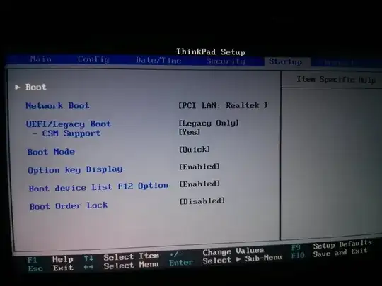

I read about disabling the UEFI mode in the BIOS, which I did, but I still got the same result.

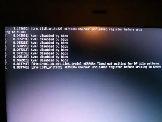

Error before the login screen: enter image description here

After looking at the logs I would advise you to try these:
  • Go into your BIOS and change you graphics to only use the integrated intel VGA card. Looking at the Lenovo user guide you can do this at the Config->Display->Graphics Device option, change that to Integrated Graphics. (You may also need to change Config->Display->OS Detection for switchable graphics to Disabled) In the live session the intel card was used, and you had no problems, but the installed ubuntu is trying to use the proprietary nvidia driver.
  • You may try booting with the nomodeset kernel parameter which usually solves problems with the nvidia driver. (But I don't know how nomodeset behaves with switchable graphics)
  • For me your logs doesn't show anything failing (but the constant (II) modesetting(G0): Modeline "1920x1080"x0.0 151.60 1920 2010 2070 2220 1080 1086 1095 1138 -hsync -vsync (68.3 kHz eP) might mean that there is a problem, I don't know this.), so I still think that this might be only a problem with the backlight not turning on. So you may try increasing the backlight with the backlight combos on your keyboard.
