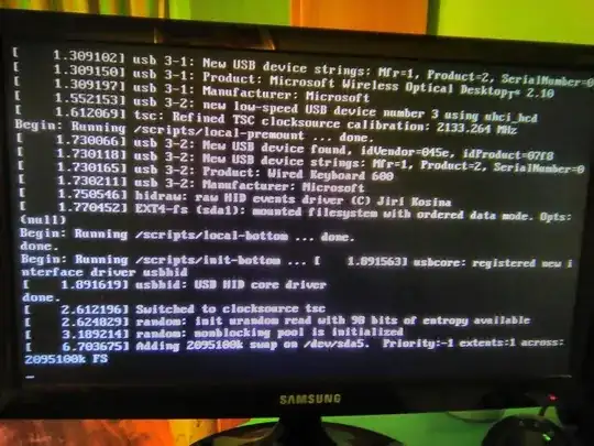

Tried to boot replacing quiet splash with nomodeset in the grub menu and then:
Nomodeset mode boots to another dead end. This adding swap thing lasts for a couple of minutes and then goes to black screen.
What can I do to resolve this?
if you have an internal graphics card in addition to your nvidea graphics card you can try to temporarily remove the nvidea card (or disable it in BIOS/UEFI), install ubuntu, then the nvidea drivers and finally reactivate the nvidea card: see also this answer: https://askubuntu.com/a/755667/538840
or you can try to use ubuntu 16.04, which may already include the relevant drivers.
