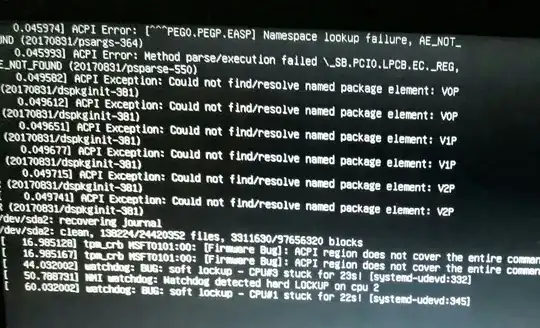

I have a problem starting Ubuntu, which I don't how to solve. It's difficult for me to describe my problem exactly, because I'm new in the Linux world, so I posted a picture of the problem:
picture for the problem

The problem has been resolved. The solve : Step 1: when you get this screen : https://i.sstatic.net/xF2Ni.jpg Press key 'e' Step 2 : You will get screen after step 1 From this screen move the pointer to line starts with linux word in last this line add acpi=off then press ctrl+x . After that your ubuntu will start. step 3: After start ubuntu open the terminal and write this commands Command 1:
sudo gedit /etc/default/grub
Then add acpi=off like this : https://i.sstatic.net/ZYP4G.jpg Then save . After that from the terminal write this comand . Command 2:
sudo update-grub
The end.
