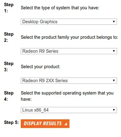

    a) open http://support.amd.com/en-us/download b) select your options (the screenshot below displays my case)
