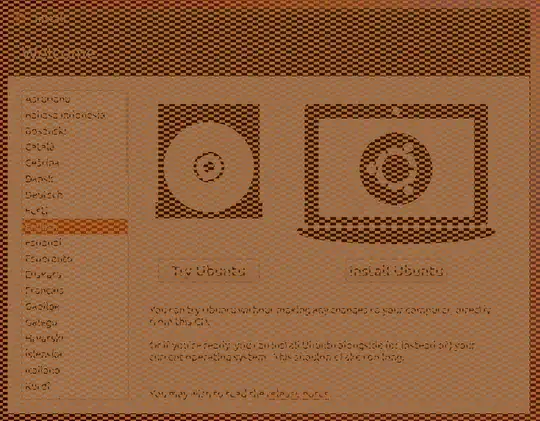

Haven't found anything about the issue I'm experiencing and would like someone to help me with it. I'm trying to install Ubuntu 14.04, but for some reason installation does load, but I get on monitor tiles of size 4px by 8px in zig-zag black/orange and can't see anything from them.
Managed somehow to get to select screen, but that is where issues start since I can't discern what option is what.
Anyone has idea how to fix it?
See screenshot below:
Try booting with nomodeset. After installing, you can install the proprietary drivers which may help. It would also help to get this fixed if you could file a bug for your problem at http://wiki.x.org/wiki/radeon/
